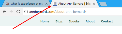

Might want to update the favicon. Still uses Bluehosts icon. :)
